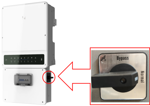

GoodWe is aware of the potential misuse of the BYPASS switch in the market. In order to ensure the safe and correct operation of the inverter, GoodWe declares that the BYPASS switch must remain in Normal Mode at all times, except in the event of an inverter fault where the unit has ceased functioning.
The correct Normal Mode position is shown in the reference image below.
Incorrectly placing the switch in the BYPASS position may pose a serious risk of injury to individuals working on the switchboard.
